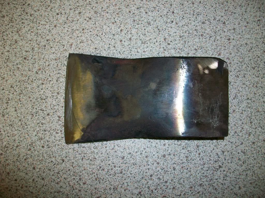

the axe was an axe but had a splitting shape head (car boot £2.50) so i took the blow torch to it then the grinder, this made it more GB style cutting bit just a bit thicker..........as you can see though when i polished it up a bit for the temper it cracked so its now scrap GUTTED........took ages too.....
