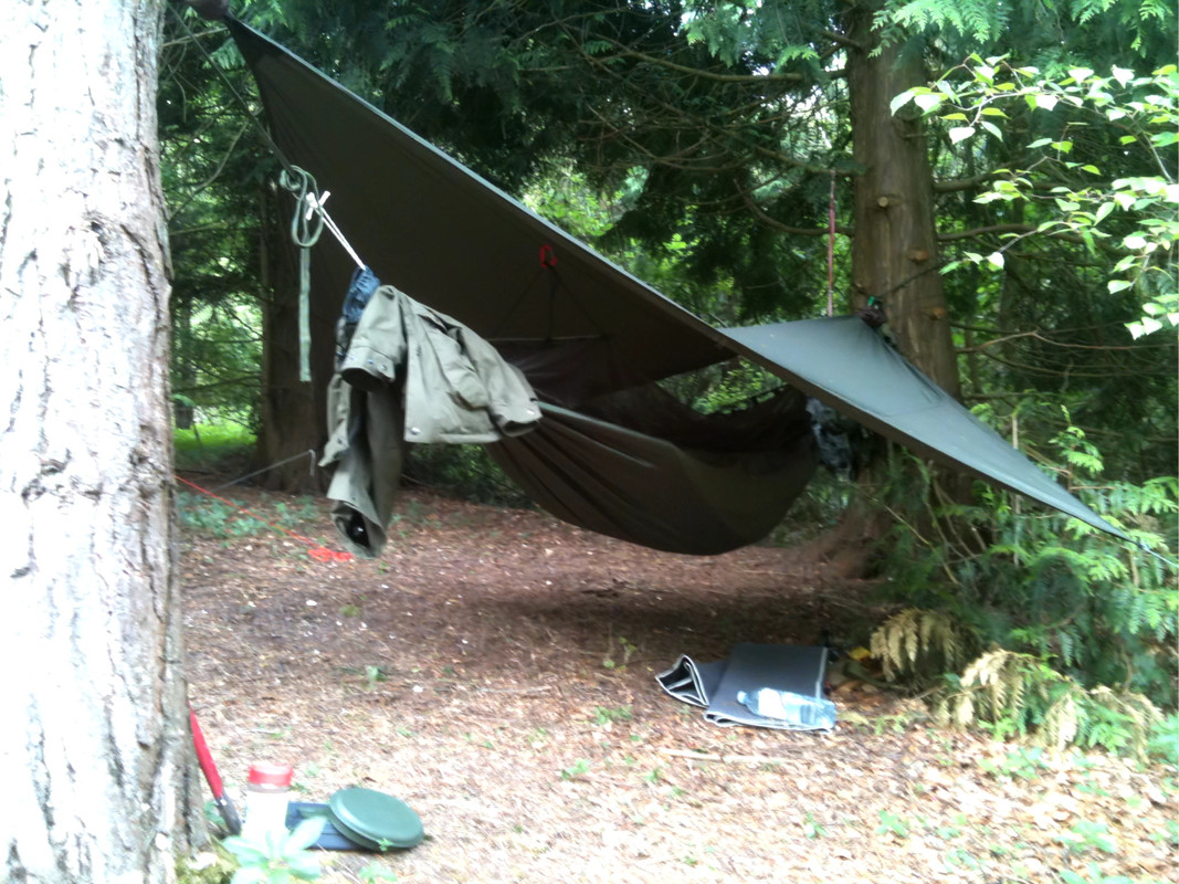

The 3*1.5m comes from the size of a certain rain cape. I guess I have to make a few tests, too small is too small so I may have to get a tarp too. The weight. Thx, that pix explains a lot.
That pic was back in 2010 at a favourite spot. Only 3 of us went on the Friday afternoon because of a heavy rain forecast for Saturday. And rain it did! About 6 hours of it, spent in our hammocks for the most part, trying to roll a bottle of tequila from one to the other, and smoke some Cuban cigars I’d been given. Nice to be able to see out. Probably one of my most enjoyable hammock trips. :)

Ah, an edit needed here. That’s the Jungle Fly from Mosquito Hammocks. it’s 4m on the diagonal, I sold that hammock and tarp, used a DD since in the same configuration, it’s just got bigger wings.
http://www.mosquitohammock.com/
DD 3x3, same place.

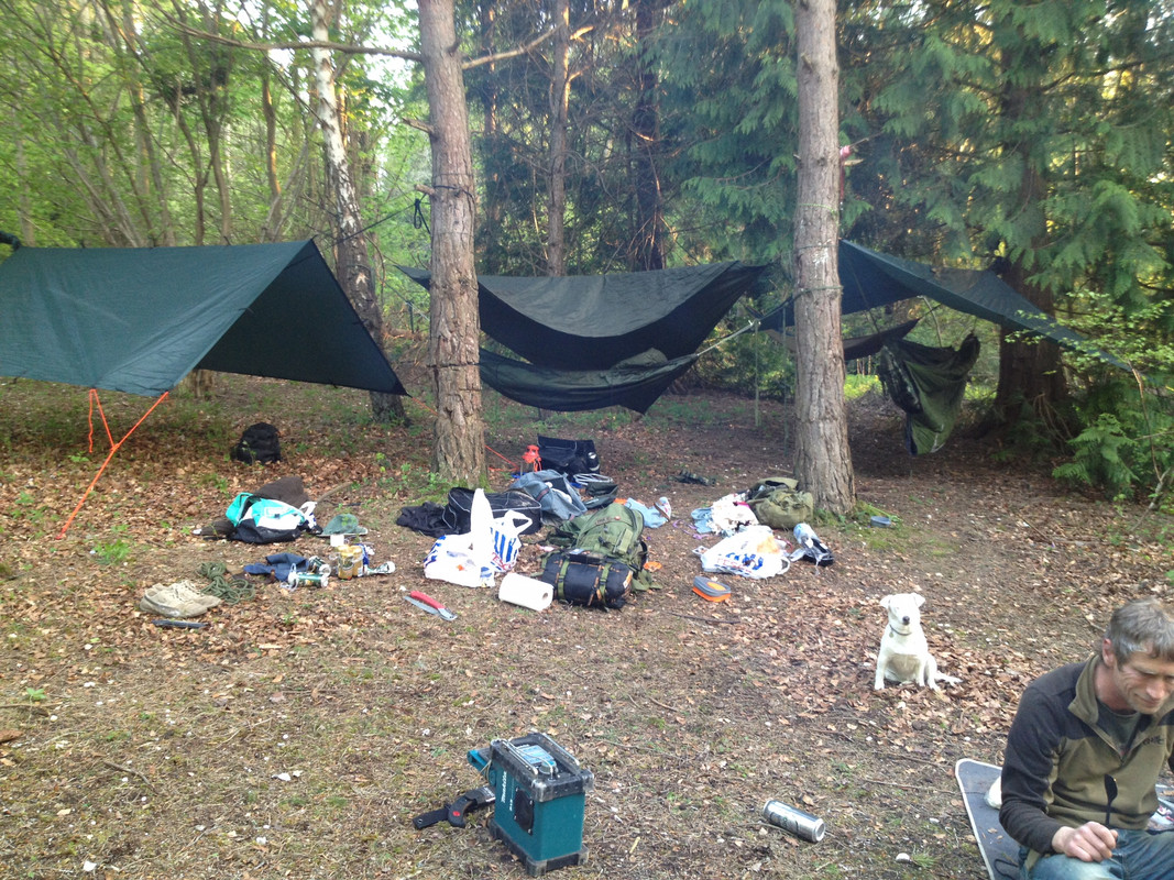

This was the 4x4 at the moot this last August. Huge area to stay dry and work in.
This was the year before at the wilderness gathering with the 3x3. Still lots of room.

What is your opinion on the shape? Diamond, square, rectangle.
Because I only use it for hammocking, the diamond by Mozzy Hammocks. You can see how it forms a lovely canopy in the first pic. The rectangular DD offers tons of options and does the job well, but I’ve never got that cool, taut shape with it. Square is good, especially if the wind is scooping in one side. I put the ridgeline inside and don’t use the external tie outs for the ridge. That way the DD can be slid over to ground level on the windward side.
