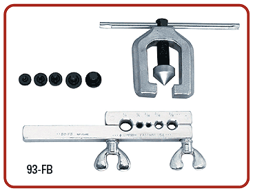

Is it to hit soft metals with? Does anybody know the intended use for such a hammer? And does anyone know the use of the following item? I don`t know anything about it but it looked interesting to me.
The largest hole has a diameter of < 1cm. That rules a spaghetti-measurer out already...

Not sure what the little clamp is but fascinated to hear ideas

Looks like a brakeline flaring tool to me as well.

Thanks for all input here guys! I followed hogs link and saw this picture:
That got me thinking, so I went through the box of stuff I salvaged and found the counterpart to this set:
And they go together:
Made by "imperial brass" in chigago US. I`d have never guessed what it was for.
