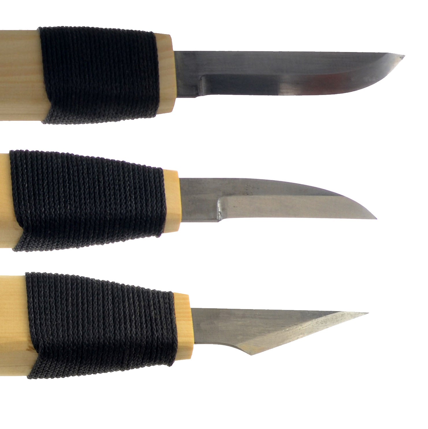

I would carve with that knife. No reason on earth to "cut" the tang.
Surface mount the blade in typical Pacific Northwest First Nations style.
The blades do not work themselves loose. I carve with dozens of them, many I assembled.
The next one you make, hook the tip maybe 7/16" and put the bevels on the inside of the curve.
If you need any inspiration, these bladesmiths have good pictures.

cheers Robson! Those kestrel tools look the absolute bomb, amazing. There's a lot of food for thought there, I think I may bend it back the other way to get the bevels the other way round and put more curve in the tip more akin to those of the north bay forge. I'm well up for surface mounting it. I still have to cut it though, the pic doesn't show it but the tang is about 25cm long currently!

Don't change the sweep at all. Make another knife instead. You will find that having a variety of sweeps
from strait to half-circle with some with J-shapes and hooked tips all have their uses.
I learned by starting with both new and used farrier's hoof-trimming crooked knives.
Mostly bash off the factory handles and surface haft the blades. Good wood carving tools.
I needed to do my damnedest to avoid getting tangled up in the bladesmithing world.
I'll just sit and watch you slave over a hot forge.

Definitely keep it as it is and try it out. It looks good so far. No carver has just the one knife or chisel, the best have a few tools that only come out of the box for a specific task, better to make more than overwork that one.
