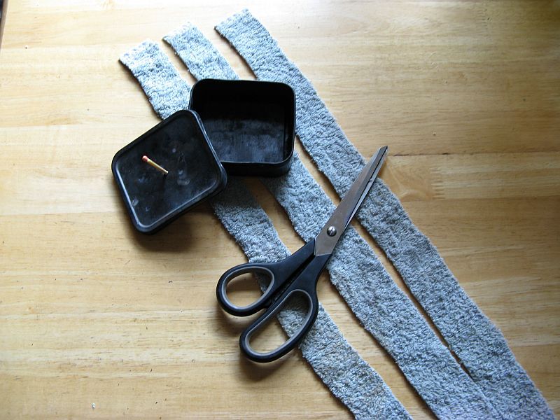

cutting towel into rough one inch strips
01%20strips_zpsticx7l9p.jpg~original

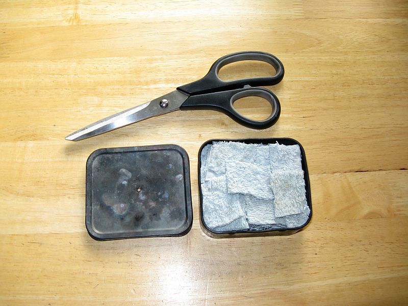

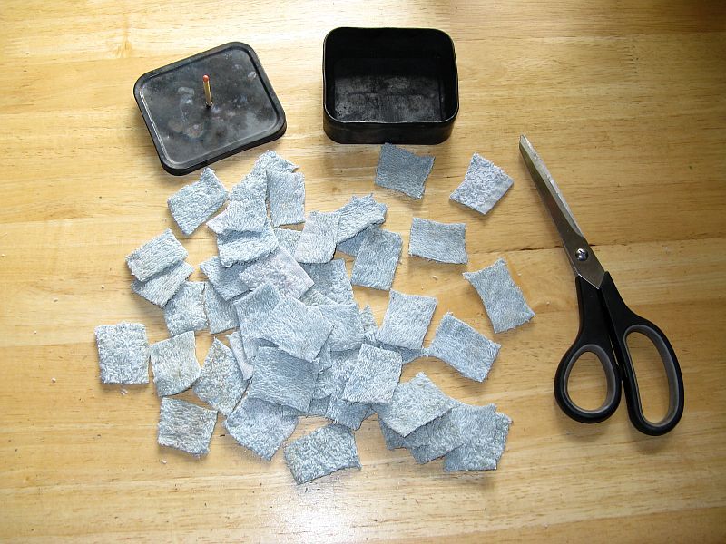

place in the tin, here a one ounce tobacco tin with a nail hole about the size of a match in the lid, the one in the photo’s only to illustrate this
02%20cut_zpskxdigwn5.jpg~original
03%20packed_zpso67wltrk.jpg~original

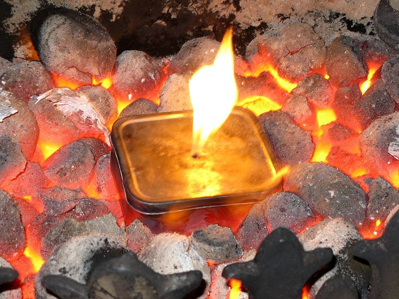

then in my case onto the fire though a B-B-Q or camp fire or even a blowlamp will do for as long as the smoke from the hole burns
at first there might be too much pressure but it will catch and burn with a roar then begin to die down
04%20on%20fire_zpswepxum2s.jpg~original

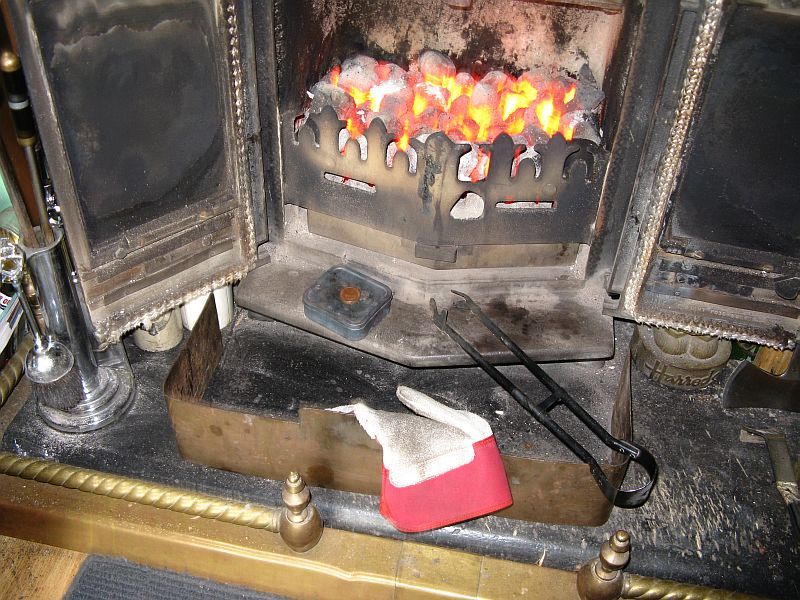

wait until it’s about candle flame size and remove from the fire and cover the hole up,
I find a coin works well, to stop any oxygen then it doesn’t smoulder away
05%20out%20penny_zpsxwltmy5r.jpg~original

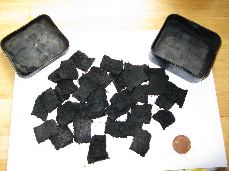

when cool off with the lid and “Jobs a Gudun”
06%20chared_zpsml4gms6k.jpg~original
if it’s not black but still brown it needs to go back on to the fire, but you soon get the hang of it
and even chared the towel keeps it's small loops which are idel for catching a spark
