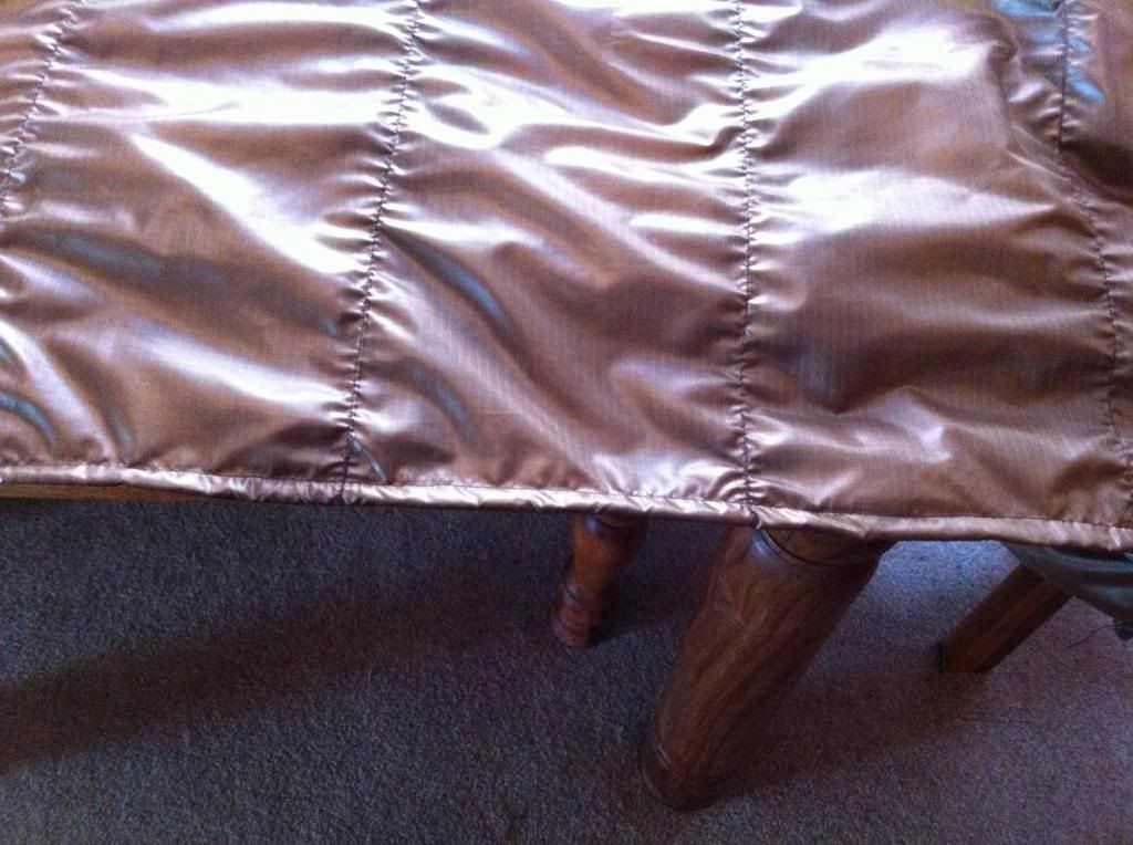

well here's an update i managed to get the darts on the bottom half done and hemmed the three sides ready for the edging to go on after i have filled it with down. i had a hard time with the hem i was abit wonky but really pleased with my first attempt and i now understand everything ready for my top quilt, atb wayne
stitching the top layer on
tacking the hem
the hem
ta da:cool:
