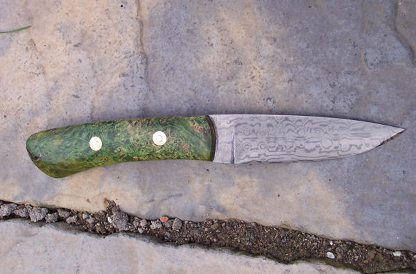

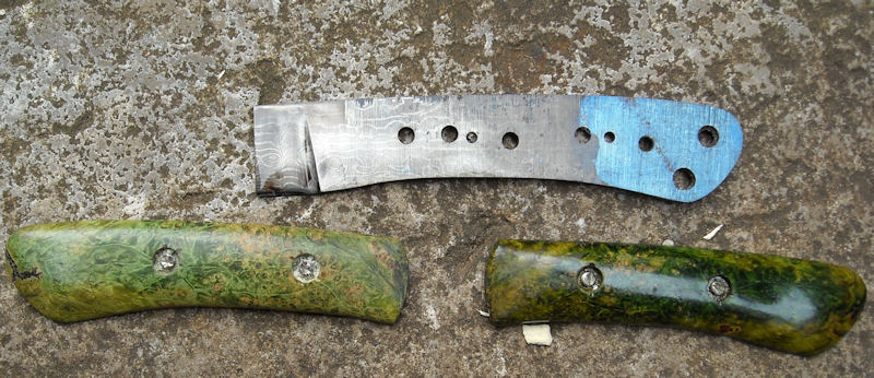

I've been perfectly happy with this knife, and I know that I shouldn't have been putting pressure on it in the way that I was. The last thing I want to do is have this tar Ben Orford's reputation in anyway.
Possibly a bit late for that.
He's a good maker with a good rep ~ a big part of that good rep is wanting to know that there's a potential issue.
Don't be embarrassed ~ we all stuff up at some point and it's usually just moments after thinking something along the lines of 'Is this safe?'. If your issue highlights a potential heat treat issue, then you're doing him a favour by getting in contact with him.

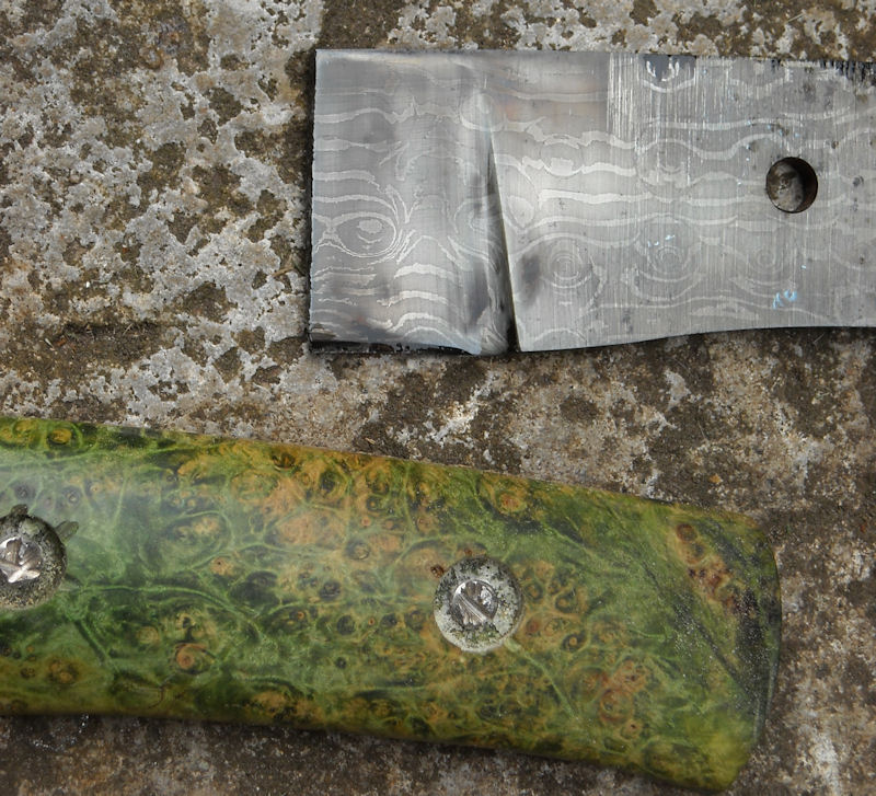

A knife that could withstand being hammered into a tree and then have someone stand on the handle could have its blade broken by the twisting force of batoning a gnarly piece of wood.
A carbon Clipper is a very tough knife and will take this much abuse:

..yet I managed to break the blade while batoning a gnarly section of Gorse:

I was googling for similar instances of this failure mode and came across this image of a broken bushcraft knife. Unfortunately there isn't a photo of the end-grain, so we can't compare the crystalline structure, but it's a remarkably similar break. Can anyone shed any light on the forces involved in this failure?
...Can anyone shed any light on the forces involved in this failure?
