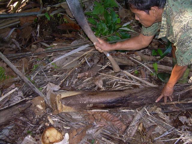

The tinder is not, as Skertchly says, from the external covering of the stem but from intermediate layers between the outer layers and the inner pith. This is surprising since his description of the tinder is quite accurate.
Incidentally, his translation of ‘tinder’ as umbut is not correct as umbut simply means the palm pith or heart of palm. Salang never refered to the tinder fluff as umbut but as lulut (refered to by Skertchly as the Malay word for tinder) which he obtained from umbut apiang (apiang palm heart).
I have only a very small Dyak vocabulary and spoke to Salang in standard Malay. He has practically no English and a limited and heavily accented Borneo Malay but I am sure on this point.
Picture - Cutting off the outer layers.

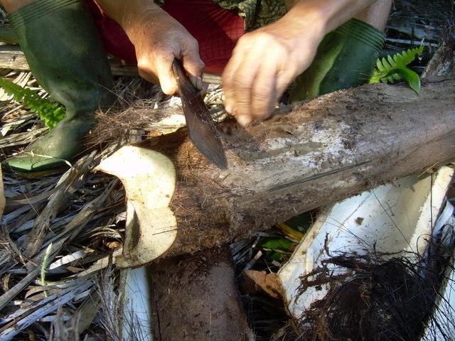

Getting the lulut is quick if you know what you are doing. Note the way he holds the parang

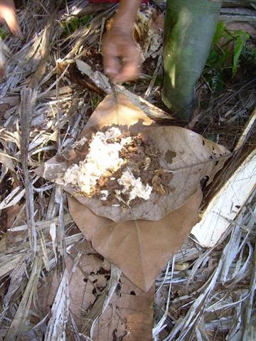

"A brown flocculent mass, quite soft. This is scraped off and forms the best tinder." Skertchy
We later brought the heart to a hut used when the Dayaks are working the fields so they do not have to walk all the way back to the long house.
The scraped lulut was then collected.
