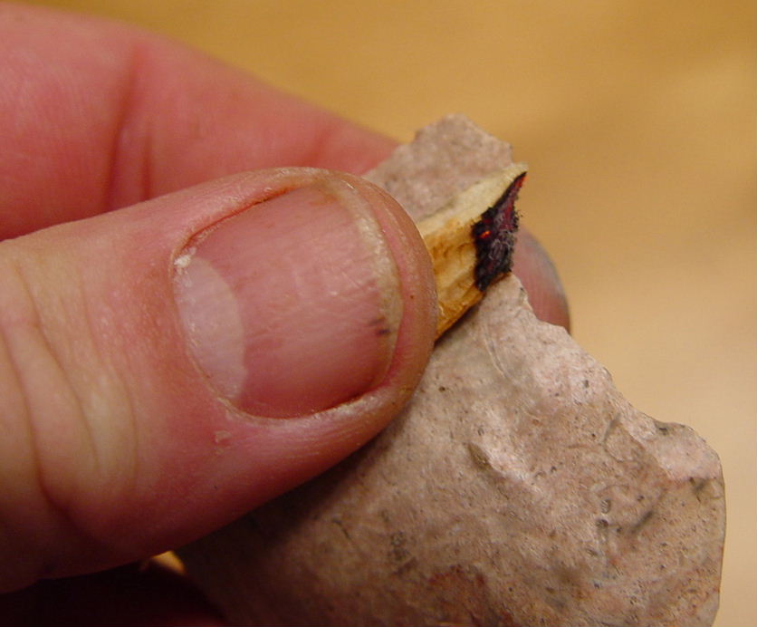

naturaltinders5.jpgNote - Tinder fungus will easily catch and propagate a spark and once ignited is extremely difficult to extinguish. Just light a small piece and try stamping it out in your moccasins – the next camp over yonder will think you’re calling for rain….
Shredded cedar bark works extremely well with tinder fungus. Prior to lighting the fungus, take some strips of dry cedar bark and pound them with a rock or large tree branch. Pull out enough fibre to form a compact ball about an inch or two in diameter. Roll this between the palms briskly to separate the fibres then fluff slightly. Flatten the ball and fold in half to make a pocket.  Now light the fungus tinder and place the coal into the pocket you made in the bark. Fold the nest around the ember and with your back to the wind, blow gently on the ember until the fibre nest begins to smoke heavily and starts to make a roaring sound. Be prepared when you hear this sound, as the nest will suddenly burst into flame. Usually three or four long sustained breaths are all it takes. Gently feed the flaming fibre nest with shavings or dry twigs, gradually building up to larger pieces, blowing as necessary to maintain flames.
Hint - To ignite flames, the fibre nest must be sufficiently compacted such that the fibres are in contact and able to propagate the ember. If too loosely packed the ember may die before achieving flames. The nest should still be loose enough however for air to circulate.

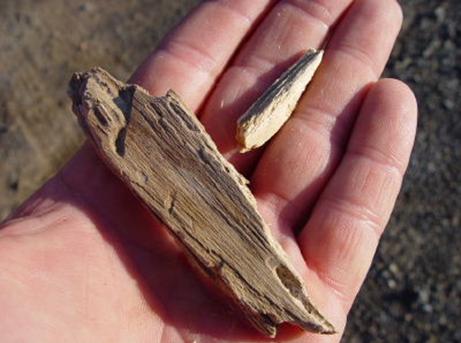

naturaltinders6.JPGIf natural fibre is not available in your area try wood punk. Dry punk from dead trees carries a coal very well. Three or four pieces of punk, placed in contact with one another, can be blown into flame all by themselves. If there is a slight breeze blowing, this method can be virtually self-igniting. Just expose the coal to the wind and let it do the work.  You can also place very fine wood shavings, twigs, birch bark or other combustible material on the punk to enhance the development of flames.

Lastly, ordinary wood punk or touch wood (rotten, decaying wood) provides an extremely useful natural tinder. While it is more difficult to use with flint and steel its abundance makes it worth the effort required in learning to using it successfully. Not only will it catch a spark but also several chunks placed in direct contact with one another can be blown into flame without the need for shredded bark or fibre. This can be extremely important to know in an area where other suitable fibres are not available. Punk exists everywhere that trees grow and even in a rainstorm it is usually possible to obtain suitable punk from the interior of a standing dead tree trunk that has been sheltered from the elements.
naturaltinders7.JPGYou can follow the basic guidelines above, i.e. placing the punk on top of the flint, however small pieces of punk tend to fragment easily. As an alternative approach, you can rub the punk between the palms, grinding it up into a fine powder. Do this over a large leaf so you can catch and later move the dust pile created. When using a tinder pile you reverse the set up and strike the steel with a downward blow from the flint driving the sparks down into the dust pile. Punk can be stubborn to catch and several strikes may be needed. Once a spark has caught, fan it gently with your hand to expand the coal. Blowing on it too hard may scatter the dust pile… and your coal. When the coal is burning well, scoop under it with the tip of a knife to lift it out of the dust pile and transfer it in your fibre bundle or punk.
Note: Save the remaining punk dust! A small metal tin makes a great place to store your remaining punk dust. And if you do not remove all of the coal but allow it to propagate a bit in the dust, the charred dust will catch a spark much easier next time. Simply place the lid on the tin when it’s time to extinguish the smouldering punk.
