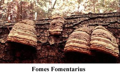

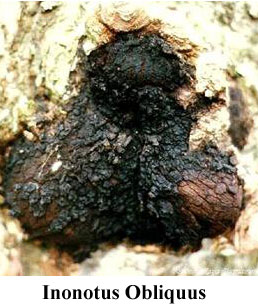

naturaltinders2.JPGWith charcloth, the fibre nest is blown into flame using the heat given off directly by the charcloth. Most of the natural tinders develop an outer layer of ash as they burn that insulates the fibre nest from the direct heat of the coal and inhibits direct ignition of the fibres – in other words…no flame. Natural tinders perform best when they are combined with a coal extender and natural fibres. (Please note that while jute, hemp, sisal and other commercially available cordage fibres commonly used in primitive fire making are natural, they do not carry a coal well nor do they grow on the North American continent.)  Coal extenders cause the tiny spark from the striker to grow and expand producing more and more heat until combustion temperature is reached.  Common examples of coal extenders include certain types of fungi such as hoof fungus (Fomes Fomentarious), true tinder fungus (Inonotus Obliquus), piths from weed stalks such as mullein, the shredded inner bark of trees such as cedar and plain ordinary punk or rotten wood. Punk, sometimes called “touch wood”, will propagate a coal as well as tinder fungus. Once the punk is touch by the glowing ember it will spread until the entire piece becomes a large smouldering coal that’s difficult to extinguish.

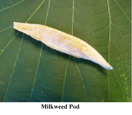

naturaltinders4.jpgOK, so we’ve been out foraging and have our coal extender ready. Now what? We need something to take the place of the charcloth.
