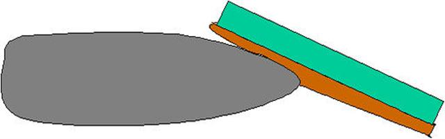

This means that it will take ages to do and will tend to sand the convex bevel flat, however much you "roll your wrist". What you need to do is put something soft between your board and the wet and dry and then push down as you push back. This will bring a lot of wet and dry into contact with the bit and will also preserve the convexing. It will look more like this

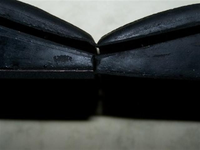

I achieve this by gluing a piece of mousemat to one of the blocks. It makes the contact area soft as shown

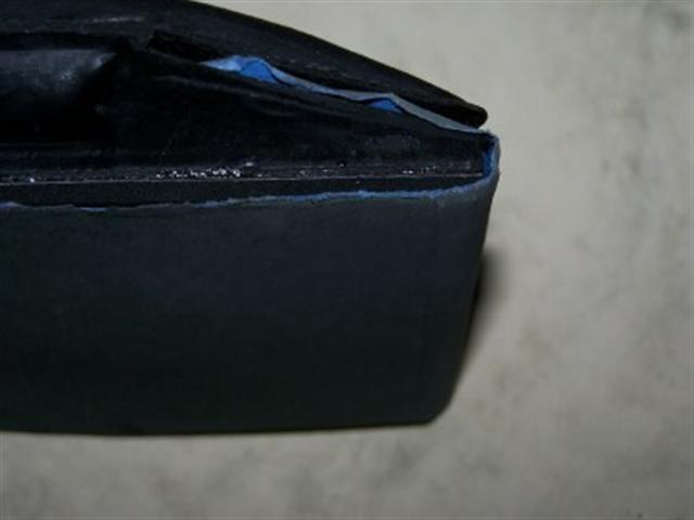

Wrapping a piece of “wet and dry” over the top gives an ideal axe sharpening tool

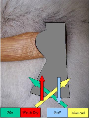

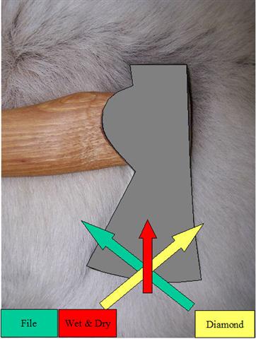

Start with a fairly coarse grit (around 400 or even 240 if you only have a coarse diamond file). Push straight back over the bevel towards the eye as illustrated.
Work through the grits until the axe is suitably sharp. I usually work up to 1,200 grit.

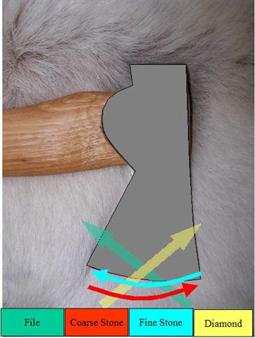

In the Gransfors system, this is achieved by using the fine side of the axe stone (similarly wet). Again, reverse direction.

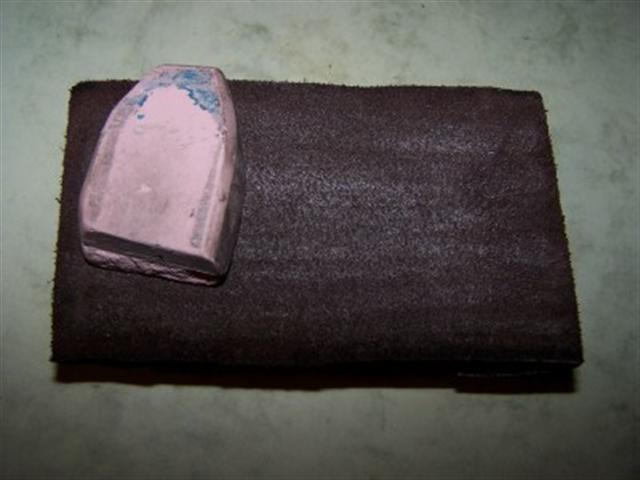

In the assembled system, we will using “buffing compound”. This is an abrasive “crayon” used to polish metal. To do this we need to cut a piece of scrap leather the same size as the “wet & dry” we have been using and attach it to our sanding block rough side showing. If you haven’t got any scrap leather you can use felt or even a cereal packet (leave the non-printed size showing). Crayon all over the leather to get an even layer of compound. Either green or pink / green compound gives the best results
Now we need to change direction again and polish from poll to bit. This will give a mirror shine and snap off any “wire” that has built up over the bit
