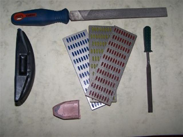

Pictured is a sharpening system that can easily be assembled in a hardware store for less than the price of one of the Gransfors Bruks tools. Not as compact as the Gransfors tools but no less efficient. It consists of
A coarse crosscut file
A fine metal file
A set of diamond hones (these are an alternative to the fine metal file)
A sanding block
A block of buffing compound

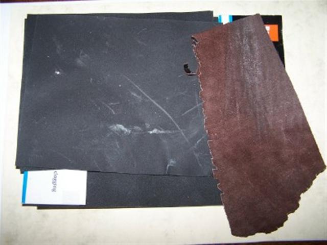

In addition to these tools, a variety of grades of “Wet and Dry” abrasive paper and some scrap leather will be needed.

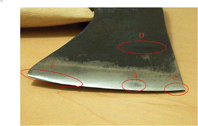

The other occasion where I find it necessary to cut back is often when purchasing a new axe.
On the photograph above, you can see that the heel of the blade (A) is blunt and rounded compared to the toe (C). There are flat areas on the bevel (B) and the ramp (D). These flat areas will detract from cutting efficiency and trap dirt and sap promoting rust. A little cutting back will correct these problems and improve the utility of the axe.
So, how do we cut back. Well the tool we use is the axe file in the Gransfors Bruks system or the crosscut file in the assembled system.

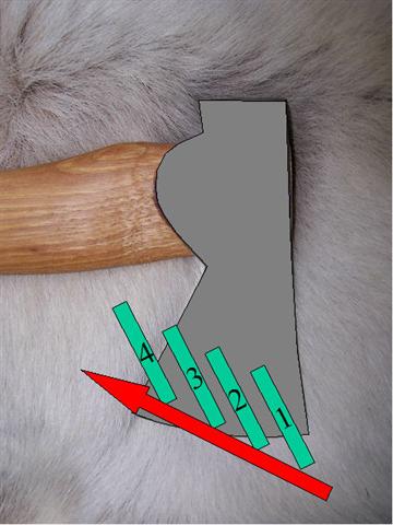

What we need to do is file backwards, from the bit of the axe towards the poll. If we file forwards, we'll "push" metal towards the cutting edge forming a wire that will block cutting efficiency. Sadly this means we are pushing towards the cutting edge. GLOVES.
When we file, because we are using a coarse file, we'll leave grooves in the metal. These are tricky to get rid of later so we'll file bit to poll but on an angle (toe to heel). At the next stage we'll reverse the angle and this will get rid of the file marks.

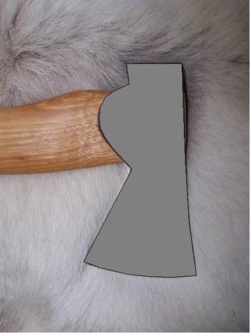

Some things are hard to photograph so I’ll need to draw diagrams. I’ll use an overlay of an axe that looks like this to illustrate the required actions
This is the desired motion - imagine the green bar as the file.

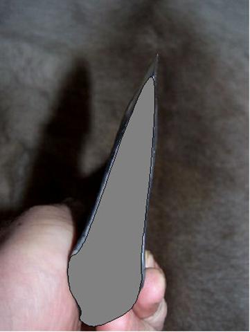

However if that’s all you do, you will file the bit flat, and that’s not what we want, so lift your hand holding the file as you push and roll the file around the convex bevel.
If this is the bevel
