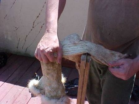

Softening the pelt over the stake. This is a lot of work
foxhide11.jpgSoftening is a matter of manipulating the skin as it dries. This can be done a number of ways, stretching it over a stake, a cable, or between the hands. The hide changes color as it is stretched, turning paler as the fibers of the skin separate. Canine skins are very thin that must be stretched gently. Too rough and the skin will rip. If the stretching stops before the hide is COMPLETELY dry, the skin will revert back to the consistency of cardboard. I use a combination of stake and hand stretching. I have a portable stake as opposed to the traditional stationary stake, and a handheld deer bone chisel.

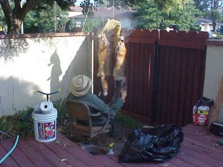

Now for the smoking. The idea is to smoke the skin side of the pelt, not the fur. Smoking a softened pelt will do a few important things. It will prevent the skin from turning hard after being wet. Smoking also discourages bugs. The color and smell it gives to the skin is a pleasant side effect, and also where the "tan" comes from. I use dry punky cottonwood; it gives a nice color. A friend of mine uses dried cow chips. I think my wife would get pretty upset if I tried to keep cow chips lying around, so I won't press my luck. A piece of string goes from the eyeholes to an overhead tree branch and keeps the hide in the right position. I have had a few folks on the sidewalk become concerned when they see smoke coming over the fence, but that is a good excuse to say good morning.

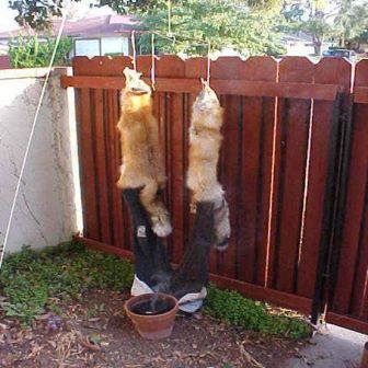

Here is my "double barreled" hide tanner
foxhide13.jpgThe bottom of each hide is sewed to an old pair of jeans legs. I use cotton denim skirts for larger hides. I get strange looks at garage sales when buying mini-skirts, but what the hell, I am in California. The important thing is to avoid synthetic cloth, it can melt. The ceramic pot has a coffee can inside and a couple of charcoal coals. To this I add handfuls of the punky wood. I keep the spritz bottle handy to dampen the jeans to prevent flare-ups. Paper towels plug up the small holes like the mouth, eyes, and front leg holes. A few sticks inside the hide will hold it open. I let it smoke until the color looks nice, usually about 2 hours. Smoking has to be watched without interruption, as a flare-up could ruin everything. I make sure to get all the personal comfort items taken care of before starting this job. If I have to leave it had better be an emergency and the hide/skirt gets hoisted off from the smudge until I return. The smoking is completed by bagging the hide for a couple of days to let the smoke set.
