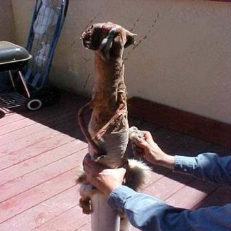

Buffing the pelt with an abrasive stone.

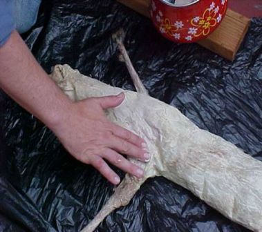

foxhide9.jpgNext step is the braining. I use a blender to mash up the brain and cook it in my old 1970s fondue pot. I think that fondue was one of the great things to come out of the 70s. My wife bought me a new fondue pot last Christmas. I think she got tired of the flower power motif. After the brain slurry is well cooked it should cool off until it is only warm. Too hot will cook the pelt; too cold will not penetrate the skin as well. The brains are rubbed into the skin, then the pelt is put into a plastic bag and in the shade. For the next two hours the pelt should be checked every half-hour. If it starts to smell too nasty, it is time to take it out of the bag and start softening.
