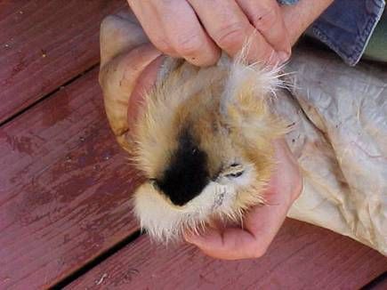

foxhide4.jpgThe ear cartilage I have approached two different ways. One pelt, I removed nearly all the cartilage entirely. The other pelt, I merely removed separated the back of the ear, leaving the cartilage attached to the inside of the ear. I don't know what is traditionally done, but I will see how the ears hold out in a few years. I use a couple of thin sticks and my fingers to separate the skin from the cartilage.
Canine hides are very thin, unlike some other critters. This means the skin can be easily damaged, so I must be gentle and cautious. Even so, I always get a few dings in the hide. Fortunately most breaks can be repaired, and from the outside, are not noticeable. The tail is a tiny strip of skin with a lot of fur hanging on it, so it probably can't be repaired easily. My very first fox hide I ruined the tail about halfway down.
