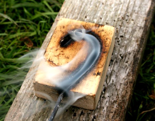

Now heat your bent skiewer up again, Really hot!

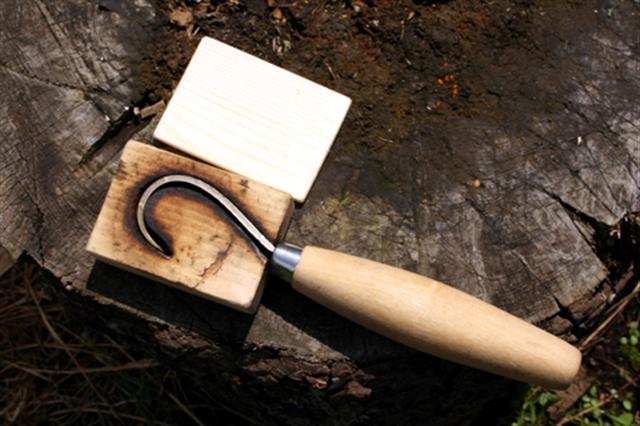

Take your peice of wood and press the red hot skiewer onto the depression you made earlier with the crook knife.
Keep reheating the skiewer and pressing it down in the same place until the burn is as deep as the blade of your crook knife. You might have to reheat the skiewer time after time to get the depression the right depth.
The chared wood may prevent the skiewer from burning deeper so you may have to scrape it out with the tip of your knife.

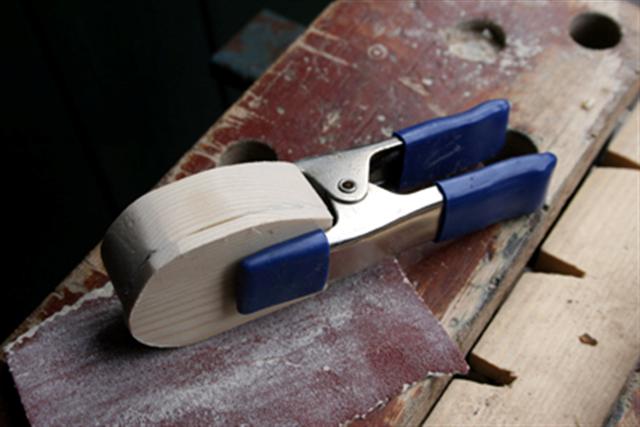

ckc8.jpgCarve and sand the block and lid to a desired shape. By clamping them together they will be exactly the same size.

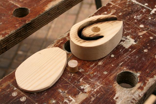

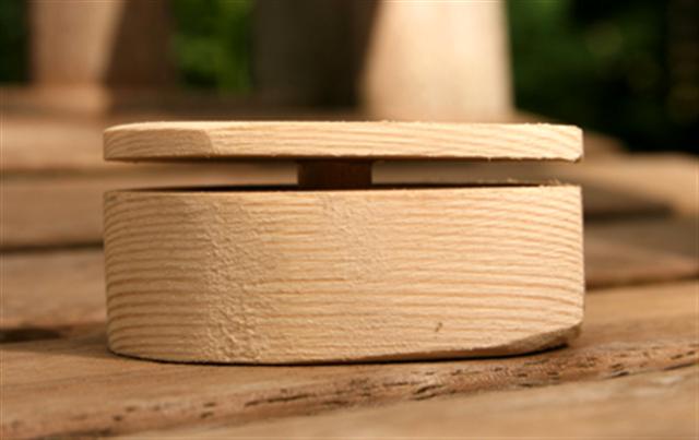

To make the lid secure in place, i drilled a socket in the main block and glued a peice of dowel to the lid.
Make sure the dowel and socket are a snug fit, you don't want the lid to come off when you don't want it to.
ckc10.jpgMake sure that everything is perfectly aligned before the dowel glue sets!

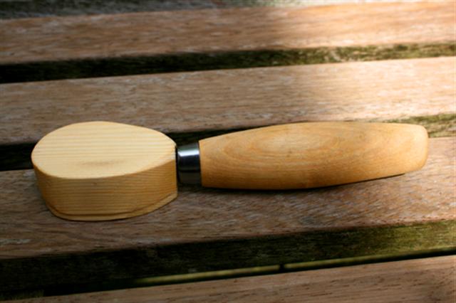

ckc11.jpgI then oiled the wood........Finished!
Hope you like it and think its good enough to have a go yourself! Any questions, please ask!
