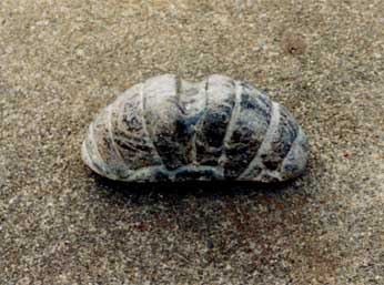

arrowstraightening5.jpgSoapstone is a superior material for arrow straighteners because it possesses three important properties. It doesn't crack or explode when heated, it is easily shaped and it is very soft and smooth so it won't scratch the wooden shaft being straightened. If you don't have soapstone then try the local materials. The first test you should do, even before you cut a groove in the stone, is to see if the stone retains its structural integrity while being heated.
Soapstone arrow straightener
© Dino Labiste 2000

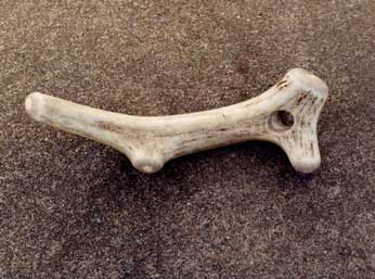

Another tool which is useful in heat straightening is the so called "arrow wrench". The arrow wrench is a 1ever about 10 inches (25 cm) long with a hole in one end. The wrench allows you to apply leverage to a small portion of the shaft. It can be made of wood or antler. The sides of the hole should be rounded in order to prevent denting the side of the shaft being straightened.
Antler arrow straightener
© Dino Labiste 2000
