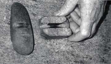

One can apply heat to the shaft in several ways. For taking out long curves you can apply the heat of a small fire. For removing kinks you need a heat source which is concentrated in a small region of the shaft. The best way to do that is to use a piece of soapstone (steatite) with a semicircular groove. Heat the soapstone until it will fry spit (same criterion used by grandma for the pancake griddle). Use a pair of tongs to remove the straightener from the fire and place it on a slightly raised platform.
arrowstraightening1.jpgTwo arrow straighteners
The smaller one was recently made from soapstone. The larger is an authentic artifact, provenance unknown. It would be excellent for removing sharp kinks.

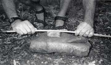

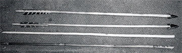

Place the part of the shaft to be straightened in the groove and rotate it. Rotating the shaft accomplishes two tasks. It applies the heat to the entire circumference of the region being straightened and it gives you a "feel" for where the high spot is. When the wood is hot then push down on both sides of the shaft to remove the bend. If you have never done this before then practice with something you don't care about. It's done by feel. This technique is especially valuable for bamboo, river cane, and phragmites which tend to collapse or buckle when bent with too much vigor. Another thing to do with shaft material which tend to buckle is to apply tension. Pulling on the ends of the shaft will reduce the tendency to buckle.
arrowstraightening2.jpg The process of straightening a shaft with a heated arrow straightener.
How hot is too hot? Ishi, a Native Californian and consummate craftsman who lived during the late nineteenth and early twentieth century’s, was disgusted with himself if he scorched an arrow shaft while straightening it. The wood should be heated hot enough to be uncomfortable to the touch but not hot enough to discolour.
