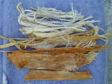

sinew1.jpgSinew, the shredded fibers of animal tendon, was used for cordage, binding points on arrow shafts, and for backing material for bows. Why sinew? What are its properties which make it so desirable for these uses? Obviously it is tough and it shrinks when it dries, but how much? A fairly extensive search of the Stanford library, asking professors of biomechanics, mechanical engineering, and archeology yielded no useful information. It looked like I would have to get my hands dirty and do some experiments on the stuff but first, what did we already know about sinew?
