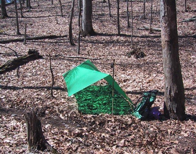

For shorter trips I still enjoy the luxury of the Golite Breeze Cave 1. It's 7' X 8.25' size is ample for one person. It also has 17 inch triangular extension or beaks on the front and back which help reduce the exposure to the elements of these otherwise large openings.
My first tarp was 8' X 10' in size and without the front and back extensions. This was large enough that I did not have problems with rain splashing in even without the beak extension's.
I also have a 6' X 8' tarp which I like to use in cold weather with the more open configuration.

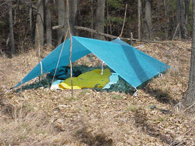

tarp8.jpgSet Up Variations: During a driving rain or just a strong wind you can stake the windward side very close to the ground. With the Golite tarp one also can stake the beak in back so that it touches or nearly touches the ground. This is what I have done in the illustrations that follow.

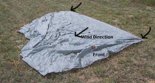

Stake the two corners on the windward side first.

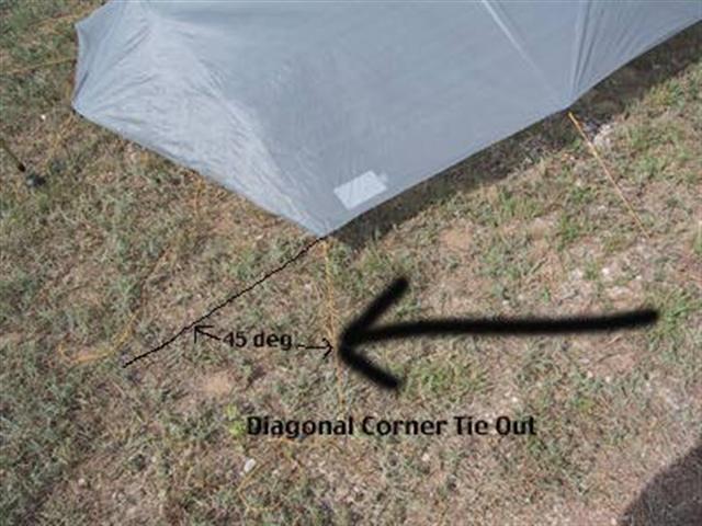

Pitch the tarp so the prevailing wind hits the side of the tarp. I stake the back windward corner first. As far as I am concerned, when these two stakes are in, the hard part is over. The tarp is not going to fly away or flip back and hit you in the face. Corners should be staked diagonally.
