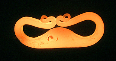

A piece of high carbon steel (an old piece of file works well),
Some charcloth (theres a guide to making charcloth on another thread )
A leather pouch to keep it in and look authentic
Okay I confess, that’s a proper "steel" just like the Vikings used - it is forged from an old file though!
