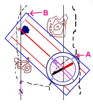

Take a map. In our first example, we look at a map made for orienteering, and it is very detailed. You want to go from the trail-crossing at A, to the rock at B. Of course, to use this method successfully, you'll have to know you really are at A.
What you do, is that you put your compass on the map so that the edge of the compass is it A. The edge you must be using, is the edge that is parallel to the direction of travel arrow. And then, put B somewhere along the same edge, like it is on the drawing. Of course, you could use the direction arrow itself, or one of the parallel lines, but usually, it's more convenient to use the edge. At this point, some instructors say that you should use a pencil and draw a line along your course. I would recommend against it. First, it takes a lot of time, but offers no enhancement in accuracy of the method. Second, if you have wet weather, it may destroy your map, or if it is windy, you may loose it. You should keep your map (preferably in a sealed) transparent plastic bag, and if it is windy, tied up, so it can't blow away. But most important is that any drawings may hide important details on the map.
Time to be careful again! The edge of the compass, or rather the direction arrow, must point from A to B! And again, if you do this wrong, you'll walk off in the exact opposite direction of what you want. So take a second look. Beginners often make this mistake as well.

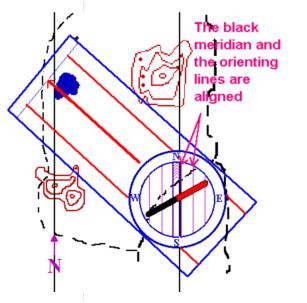

Keep the compass steady on the map. What you are going to do next is that you are going to align the orienting lines and the orienting arrow with the meridian lines of the map. The lines on the map going north, that is. While you have the edge of the compass carefully aligned from A to B, turn the compass housing so that the orienting lines in the compass housing are aligned with the meridian lines on the map. During this process, you don't mind what happens to the compass needle.
There are a number of serious mistakes that can be made here. Let's take the problem with going in the opposite direction first. Be absolutely certain that you know where north is on the map, and be sure that the orienting arrow is pointing towards the north on the map. Normally, north will be up on the map. The possible mistake is to let the orienting arrow point towards the south on the map.
And then, keep an eye on the the edge of the compass. If the edge isn't going along the line from A to B when you have finished turning the compass housing, you will have an error in your direction, and it can take you off your course.
When you are sure you have the compass housing right, you may take the compass away from the map. And now, you can in fact read the azimuth off the housing, from where the housing meets the direction arrow.
Be sure that the housing doesn't turn, before you reach your target B!
The final step is similar to what you did in lesson 1. Hold the compass in your hand. And now you'll have to hold it quite flat, so that the compass needle can turn. Then turn yourself, your hand, the entire compass, just make sure the compass housing doesn't turn, and turn it until the compass needle is aligned with the lines inside the compass housing.
The mistake is again to let the compass needle point towards the south. The red part of the compass needle must point at north in the compass housing, or you'll go in the opposite direction.
