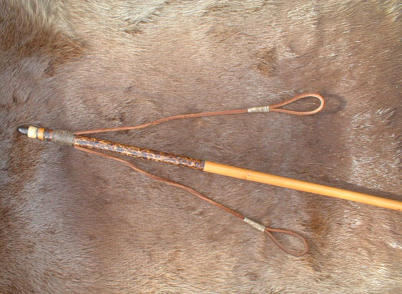

The top of the hand drill with thumb loops attached:

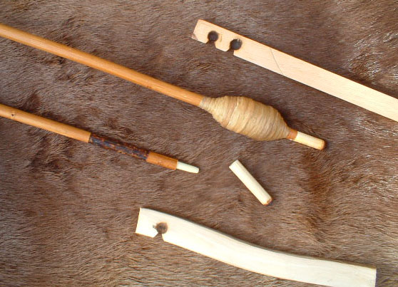

The bottom of the hand drill with an elder plug and flat stones lashed around the spindle with bark. The
plug method will also allow you to experiment with different woods, by inserting them into the elder tube.

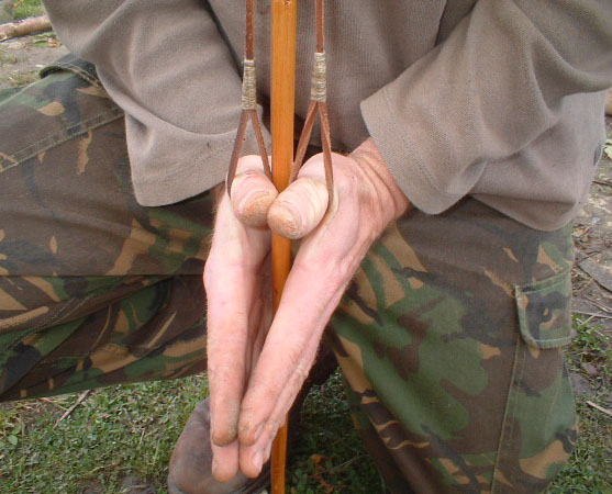

Place your thumbs through the thumb loops - this will allow you to spin the drill for longer periods and
add downward pressure, without moving your hands up and down the spindle. The added weight near
the drill tip will also be advantageous

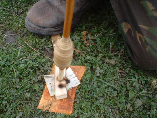

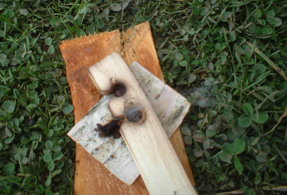

Start to spin the drill and it will not take long for the smoke to appear. Keep spinning until the smoke is
very thick and the nock is starting to fill with dust......give it all you've got.

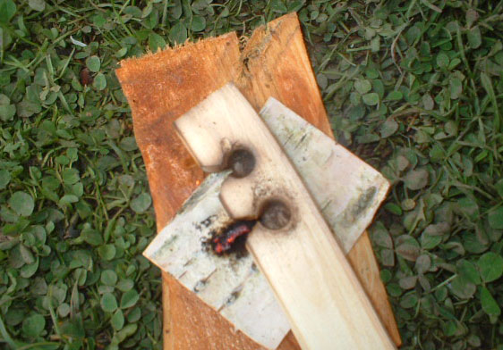

If all is well you should have a smoking ember sitting in the nock
Calmly remove drill and set aside. Fan the ember with your hand until it starts to glow.
