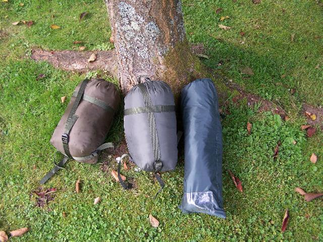

To begin with, here is the full system in its stuff sacks.
The long thin stuff sack contains the hammocks, climbing tape for suspending the hammock, a 3m x 3m tarpaulin and a mosquito net. The other two bags contain an under blanket which suspends beneath the hammock and a quilt for use inside the hammock.

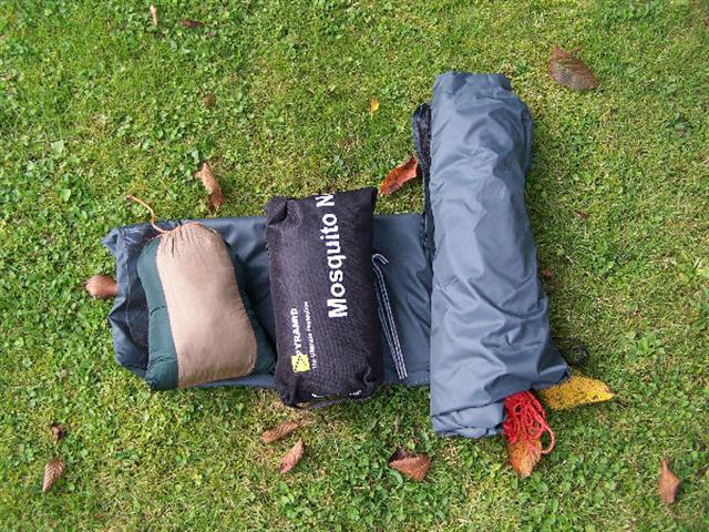

Unpacking the long stuff sack reveals the following elements...
On the left is the “group buy” hammock – sil nylon and packs into its own pocket that later forms a handy bag attached to the hammock side wall for things that might be wanted in the night. It packs to half the size of a bag of sugar.
In the centre is a “group buy” mozz net in its own bag. More on this later.
On the right is a Tatonka 3m by 3m sized sil nylon tarp. Rolled tight this occupies about the size of a 2lb bag of sugar. Again more later.

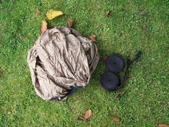

To begin with, lets sling the hammock. Opening the hammock stuff sack reveals the following items.
What you can see here is a nylon hammock and two 5m lengths on climbing tape. The climbing tape has several advantages over rope in attaching a hammock to a tree. Its flat so it “grips” better, it doesn’t stretch as many ropes do and is far less prone to damage the bark of the tree.

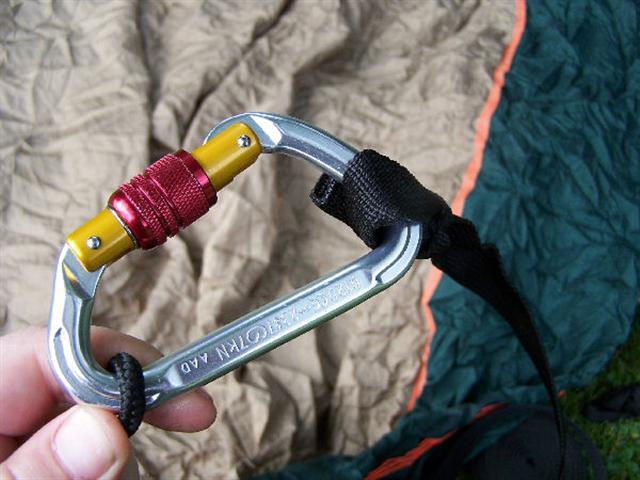

The cords on each end of the hammock are gathered in a metal hook when the hammock is supplied. I have removed these and replaced with (proper climbing strength) screw gate karabiners. I find these more secure and very easy to unclip if I want to add the mozzy net after slinging the hammock for example.

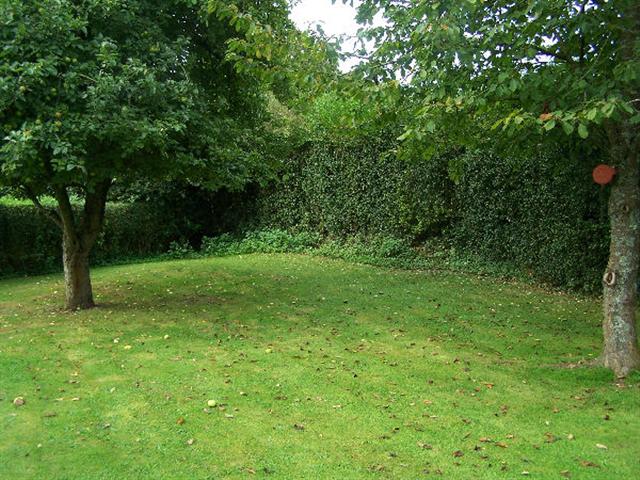

Now we need to find some suitable trees. We want two trees about 20 feet or more apart. Check both trees are sound, have no diseased limbs, heavy overhangs etc. I prefer to have the hammock out from under any branches – partly to avoid any possibility of anything falling, but also to stop the persistent “drip” after rain from the leaves. Avoid beech trees if possible – they have a tendency to shed large branches – especially if there is rain after a dry spell.
A nice healthy apple and cherry will do

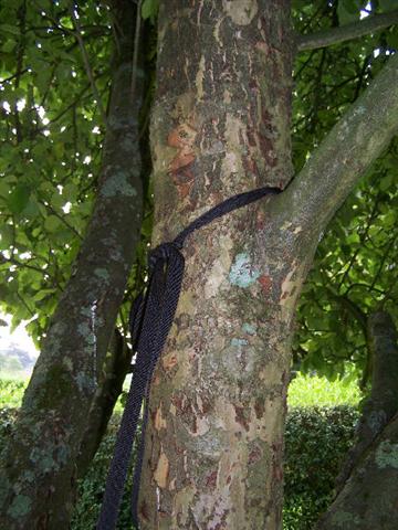

So we position the hammock on the floor and then tie up one end. I like to use an evenk hitch (aka falconers knot) for the first end – a quick release knot that lets me slide the climbing tape up the tree.
