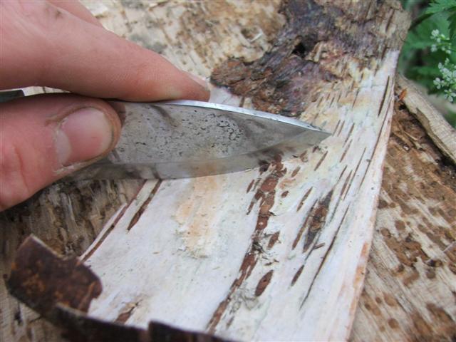

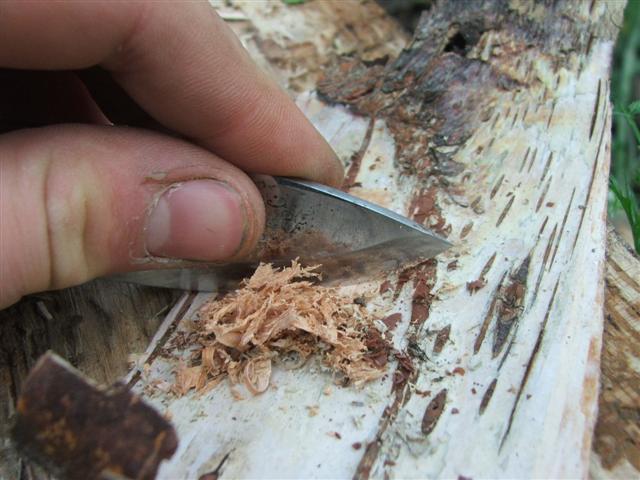

So, with the bark collected, take your nice sharp knife and grip the blade itself, rather than the handle. Hold it perpendicular to the bark and use it in the form of a scraper. Its a safe and effective method, that will rapidly allow you to gather loads of good shavings, providing you have sharp tools.
Working out the amount of shavings that are required is a guesstimation process, but its easy enough to work out after a few tries.

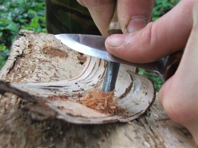

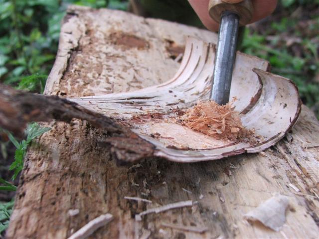

So, bark shaved, its time to firesteel. Place the steel behind the pile of shavings, ie on the side of the pile closest to you, meaning that the sparks that come off fall forwards onto the shavings. Press down hard on the steel, putting weight onto it to stop it from moving. There are methods which involve moving the steel against the spine in mid air, but I think this one is a bit easier.

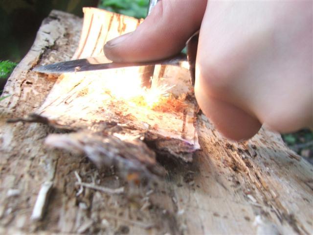

Place the SPINE of your knife onto the firesteel at the top. Make sure it really is the spine!, one time we did this with the Scouts, one of the Leaders who was new to bushcrafting but enthusiastic came after the demo had taken place, and decide to use the blade edge instead of the back. Although this method works, it severely damages the edge of the knife and is a waste of your time and effort making it sharp again. Watch out if you use SAKs though, make sure the blade is folded otherwise you could end up without some fingers...
Now as you push down , force the spine into the steel hard and controlled, whilst twisting with your wrist - note the difference between the postions of the blade between these two pics. Also make sure you stop pushing before you hit the pile, otherwise you'll probably end up squashing out any flames you make, and scatter all your shavings everywhere too.

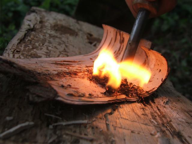

Providing everything has been done well, the scrapings should ignite on the first try, as there is a lot for the sparks to get hold of. Using a firesteel is quite tricky and takes practice, but is no way as hard as bowdrilling or handdrilling (somethinf which is currently defeating me, but hopefully not for long )
After getting the flame, hold thin ripped of strips of bark in the flame (don't just chuck them on the pile) until they ignite, then add bigger bits followed by sticks and your normal firemaking routine. The whole process should take about 30 secs or less.
