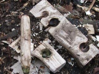

Firstly , look at this well used set:bowdrill2.jpg

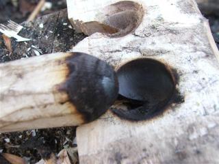

The drill and a socket are like hand and glove. This is because the burning has smoothed off the rough points of the tip and made it fit properly. Therefore we don't need to worry to much about getting a perfect fit when carving it out.

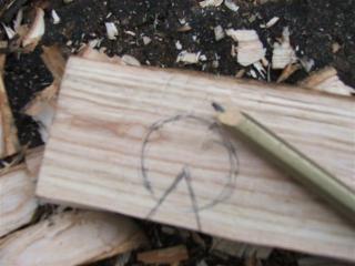

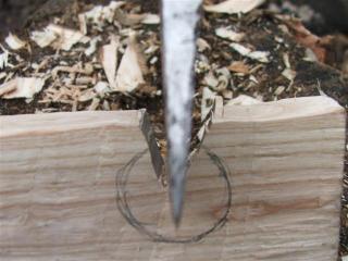

I have sketched onto this piece the shape that needs to be carved:
I don't normally sketch it on, but it shows what we are aiming for. A circular depression and an 1/8th section notch with straight sides. I tend to chop the section out with axe and knife, but you could use a saw.
