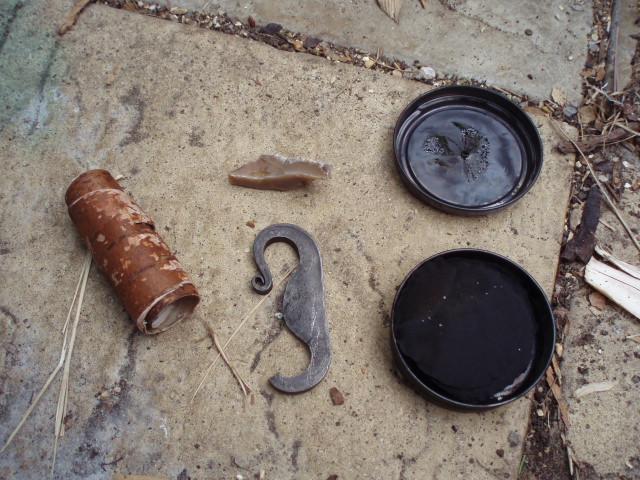

Next, you need your firelighting kit. I'm using a traditional flint and steel, together with charcloth made from an old pillowcase, charred in a boot polish tin.

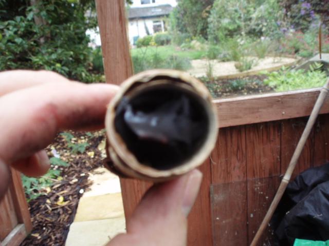

Strike a spark onto the charcloth, make sure it is glowing nicely, and insert it into the gap that you left at the end of the tube. Push it into the tube with a bit of twig to make sure it is in contact with the tinder.

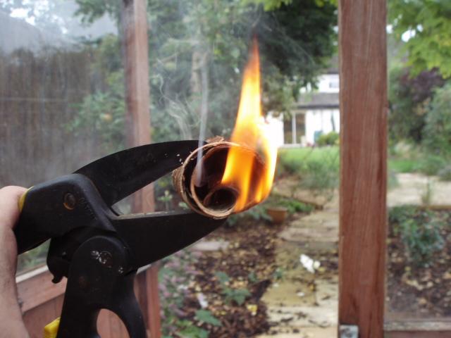

Now, blow into the end of the tube, and as you draw breath do the Ray Mears thing of sweeping the tube down while you take a breath, then bringing it back up to your mouth. Soon, you should see clouds of smoke billowing out of the far end of the tube. There was smoke here (really), but I had to stop blowing to take the picture of myself.
The tube can get hot, so you may want to make a pair of 'pliers' out of a couple of twigs, or grab whatever is near at hand (in my case my garden secateurs) to hold it. At Woodlore, the instructor managed to get flame while still holding the tube.

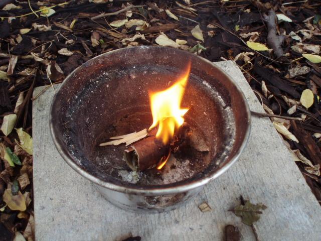

Finally, put the tube into the base of your fire...
...and add your kindling and fuel.

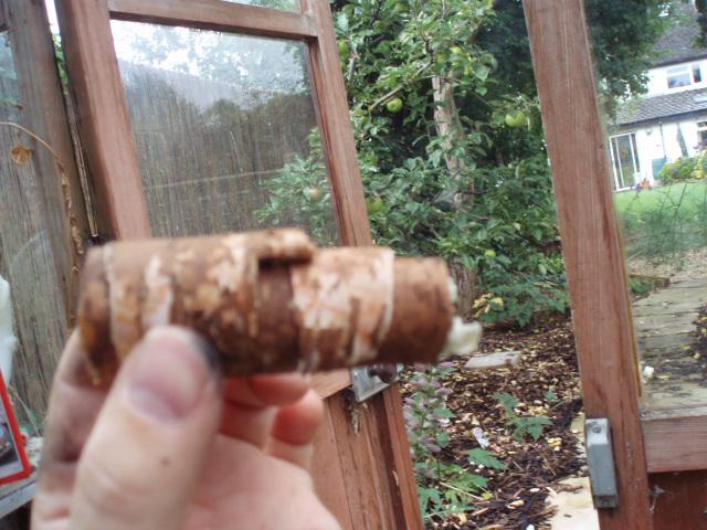

Hope this is of use. The 'cigar' is something that could be prepared in advance and taken out into the woods in a waterproof container, to help light a fire quickly if there isn't anything else readily available.
Next time, I'd probably use a longer tube and maybe only fill it half way with tinder. That way I could hold the tube at the 'mouth' end and, hopefully, this won't then get hot, as the flames should only occur at the far end of the tube.
