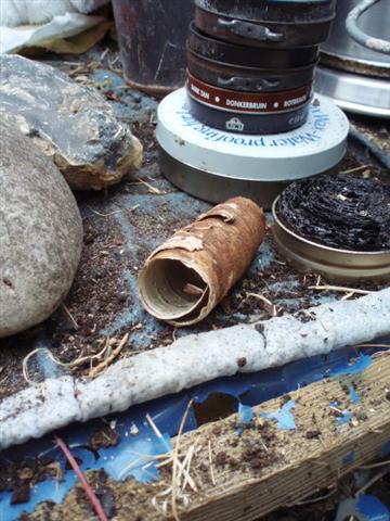

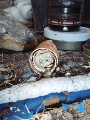

To start with you need a piece of curled birch bark (not the papery bark, a piece of proper bark) cut from a fallen branch or tree. I'm sure I don't need to say this, but don't cut it from a living tree. The bark will usually curl naturally as it dries out after removing it from the dead tree.

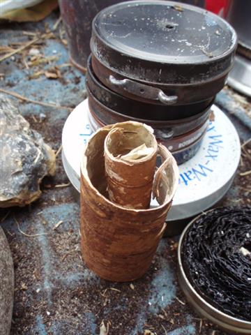

Now, this piece isn't really too good as a tube, so if it looks like this, unroll it and then re-roll it so that the end of bark that was in the centre of the tube is now on the outside. It should then take on a proper tubular shape.

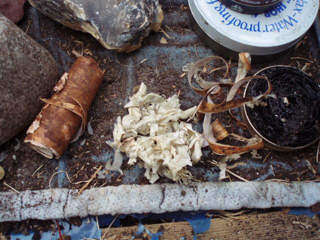

Next, you need some tinder. I am using the papery birch bark (which can be peeled from a living tree if it is peeling already) and some shredded bark taken from a dead tree.

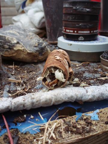

Pack the tube with the tinder, leaving a gap at one end of the tube.
The tinder should extend all the way to the other end of the tube.
