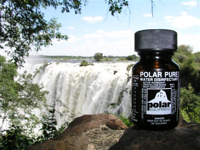

victoria fall (Small) (Small).JPGIn the depths of my bag resides one such tool, a small brown glass medicine bottle of the type that always seems to be unearthed when digging in the garden. It has travelled with me through the thirst-lands of the Kalahari, the frozen tundra of the artic circle, the scorched deserts of the Middle East and the teeming jungles of South East Asia . Its medicinal appearance is perhaps appropriate, as I depend on it to keep me healthy.
In the years that I have possessed this little 3oz bottle of unremarkable appearance, it has been used to treat almost 1000 litres of water, some of it decidedly foul. Yet the presence of a small pile of glinting metallic crystals trapped inside assures me that it will treat 1000 more.
Like some magical item from the rulebook of a dungeons and dragons game, from this deceptively small receptacle springs forth a seemingly unlimited supply of the means to create of one of the most fundamental requirements for life, safe drinking water

 “POLAR PURE WATER DISINFECTANT – Danger keep out of the reach of children”
Like all truly good tools, its brilliance lay in its simplicity.  It’s a stout brown glass bottle reminiscent of old fashioned medicine bottles but with a modern adult proof cap.
At first you might be concerned that, being made of glass, it may be inherently fragile, this concern will vanish the first time you fumble it on a pebble river bank and it bounces.  You’ll understand then, why you keep finding these bottles intact under your lawn and strewn in the rubble at building sites, they are nearly indestructible.

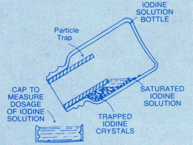

Inside the bottle is a small pile of iodine crystals, and printed on the side are directions for use and an extremely clever dosage table (more on this later).
When unpacking it initially needs to be filled with water (dirty water is fine), capped and set aside for an hour, during which time a tiny portion of the iodine will dissolve in the water until it reaches saturation point and no more can be dissolved.
This step need never be repeated, with your solution prepared, you can now store it full.
