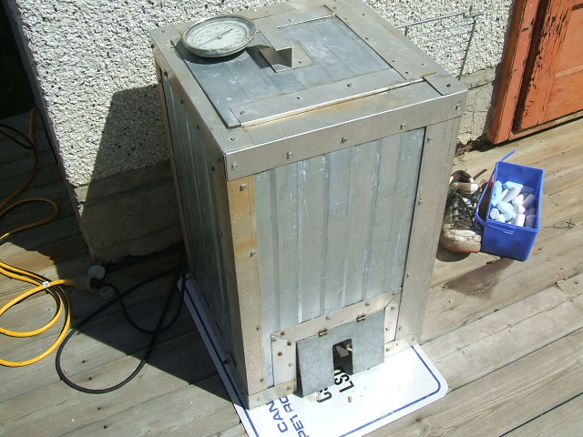

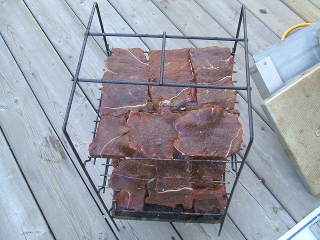

Then I placed the meat on the racks in my smoker. I had to do this in three batches, as my homemade smoker isn’t big enough to handle that much meat at once.
The smoker is designed to be used with a hotplate, propane stove or even placed over a smoky fire.

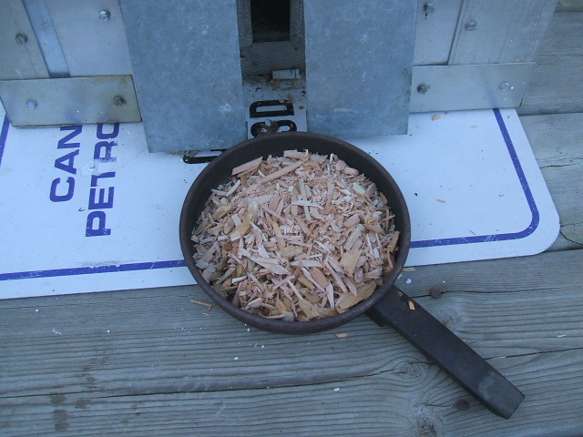

I used a pan of apple wood chips and used the hot plate to heat the pan of chips to smoking temperatures. The chips ignite and begin to smoke but don’t burn quickly.

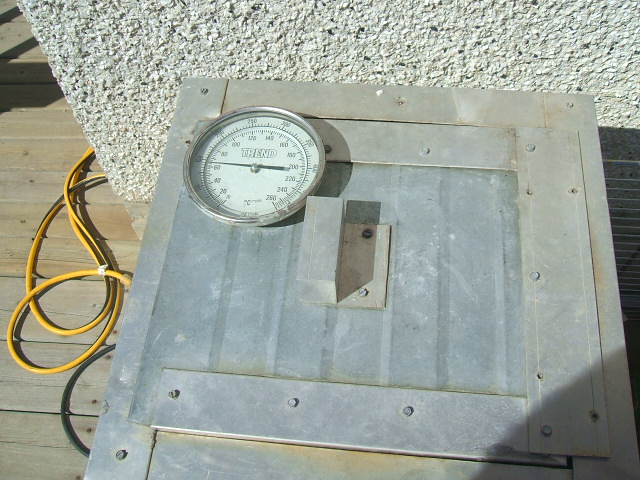

The interior of the smoker stays at a pretty constant 150 degrees Fahrenheit. To save time I smoked the jerky for around 4 hours per batch and then finished drying the meat in my dehydrator.
From 12 lbs of fresh meat I ended up with 4 lbs of jerky. Not counting the half-pound or so of samples that the kids and I ate.
