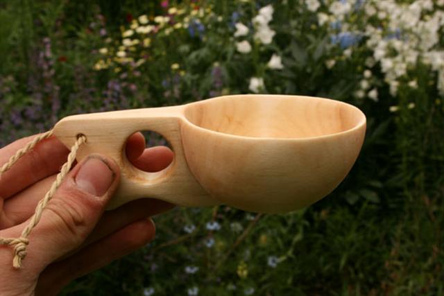

Kuska's are traditionally made from Birch wood so that is what i will be using.

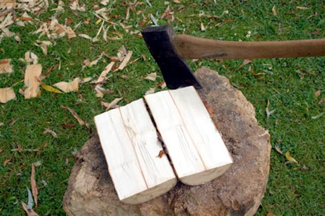

Take a log of fresh birch wood and chop it down the centre with an axe.

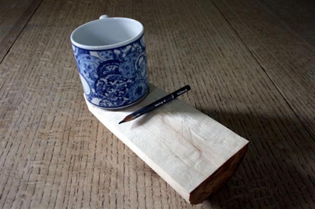

Draw around a cup or round object onto the flat surface of the log. Use this line as a guide when you are carving.

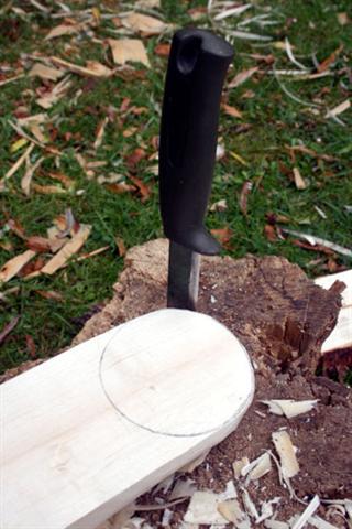

Carve around one side of the circle like so:
Now carve the underneath to make nalf your cup shape. You will be needing an axe for these jobs because there is quite a lit of wood to remove.
