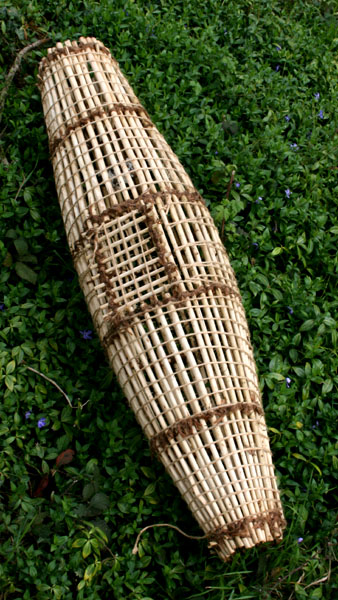

If you find that your cage construction has large gaps in it then you can wrap string round the whole thing evenly so the little ones cant escape!

I hear that these traps work best in rivers with the entrance facing upstream but i use mine in a lake and it works fine.

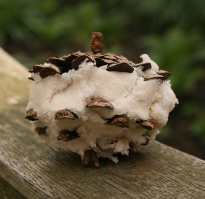

For the bait i stuffed a pine cone with bread and suspended it in the centre of the trap with 2 bits of string. I located it near to the entrance.
Weight your trap down with rocks and put it in the water. I put mine on a line of string so i could pull it back to the lake side. I pushed it out with a long stick.
If you don't catch anything at first don't worry. It may just be a case of changing a few things.

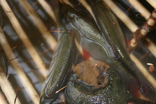

Here's what i caught on my second day of fishingYou may need to leave the trap in for a long time but always remember to regularly check it!!
