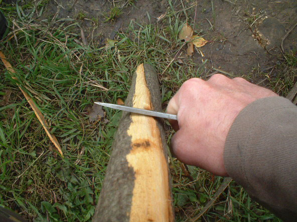

BARKTUBE1.jpgStrip off a length of bark (lime in this case).

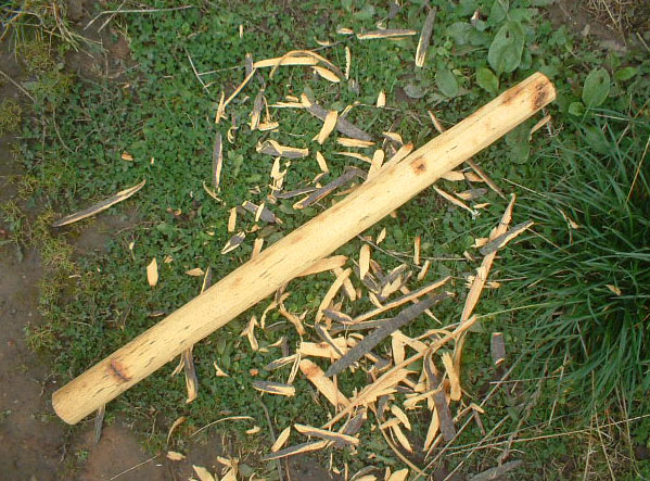

BARKTUBE2.jpgLeave to dry in the sun and it will naturally curl inwards and shrink.

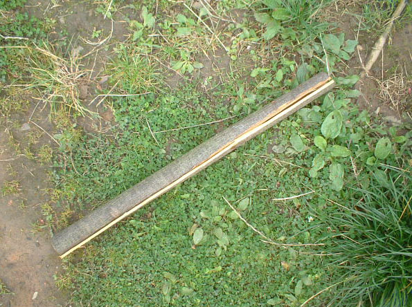

BARKTUBE3.jpgSplit this in two lengthways, leaving a small over-hang on one side - the tube could then simply be glued and
bound at this stage. However, be warned, I lost one of these full of hand drills to the fire a few years back - one
of the students thought it was a piece of firewood!

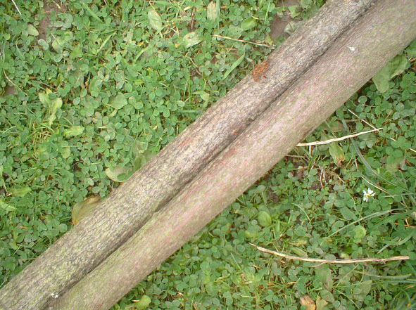

BARKTUBE4.jpgTaper down over-hang and strip outer bark off, don't cut too deeply.

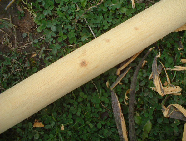

BARKTUBE5.jpgTube with bark removed.

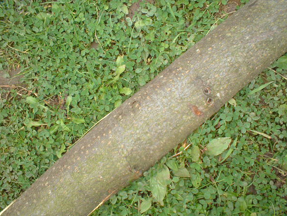

BARKTUBE6.jpgAbrade tube to a smooth finish.
