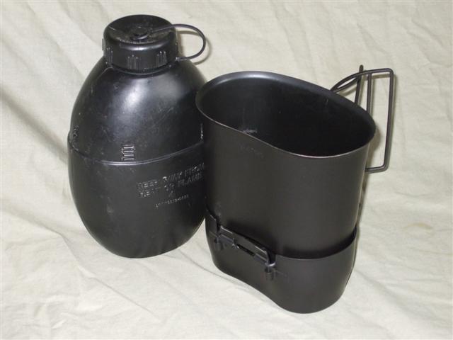

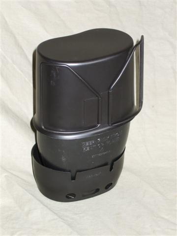

The Web-Tex Warrior Cooking Unit is a two-part set comprising a burner unit and a mug, both made from 304 stainless steel, is designed to fit around a military “’58 pattern” style water bottle and to fit into an issue pouch.  I do not have an issue pouch try this on, but the set does fit into many rucksack pockets and into my response pack.

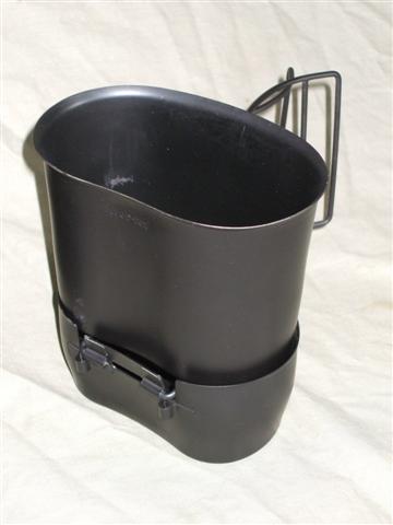

warroirunit2.jpgThe Warrior Mug is lighter than the issue item at approx 200gm as opposed to 270gm, while still holding just over a pint (600ml), has a black non-stick cooking surface and is straight sided – which seems to make it a little more stable.
There are no “measuring marks” on the Warrior Mug, but then I hardly ever have a problem measuring half a mugful by eye, so this is really no great handicap.
As ever, the danger with metal mugs is the metal can burn your lips if you are careless, but a couple of layers of electrician’s tape on the rim of the mug where you drink from it will solve this quite well, and the metal does not seem to get so hot, or the flames reach so high as to melt this tape when you cook on the burner unit.

The burner stand also acts as a windshield,which incorporates air vents.  In a mild breeze with the holes facing into the wind I found that a forced draught effect was achieved, sending flames up around the sides of the mug, but with the holes away from the wind the “burn” was slower and more controlled, showing that the windshield is effective in its role!
The folding handles on the mug stay out of the heat from the burner and are comfortable to grip, the non-stick finish is very effective (though it needs appropriate care to avoid scratching or rubbing, i.e. use wooden spoons, not metal, and gentle cleaning, not gravel), and the mug can take 2 rat pack sized pouch meals at a time (main course and those fruit dumplings in custard – yum!(?)) and still have enough water for a small brew.
