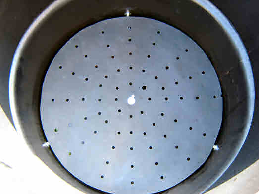

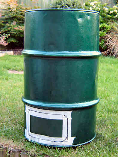

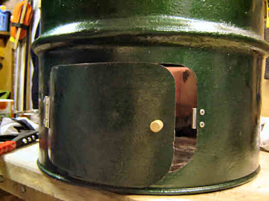

After cutting out the top and drilling the baffle, I've now added a door at the base, for lighting a small fire, or putting in a gas burner.
Here's the door all cut out and ready for use:

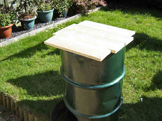

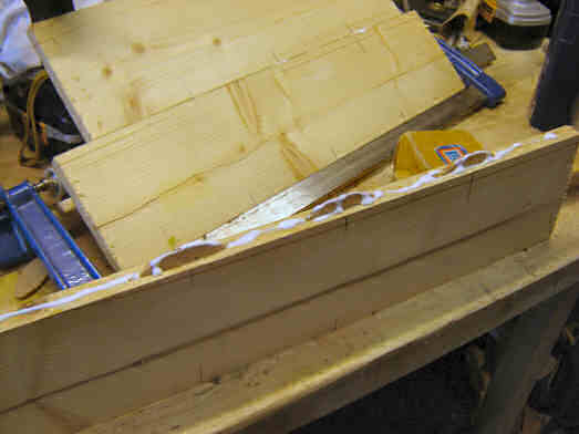

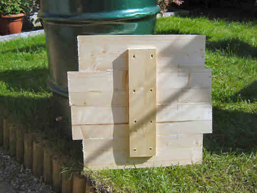

After making the door, the next job is to make a wooden top, to keep all the smoke in, I started off with 4 pieces of off cut wood from  my garage doors, and biscuited them together to make a nice solid top.Here's the top in progress:

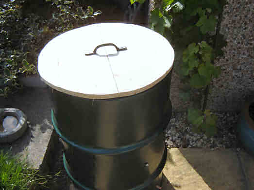

Here's the lid all trimmed up, with a handle added for easy removal.

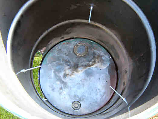

Now the lid was done, it was time to add some stops for the baffle plate to sit on, for this I used some bolts, and positioned 3 of them around the lower section of the drum. The baffle plate drops in nicely onto this, with enough height above, for the smoke to diffuse.
