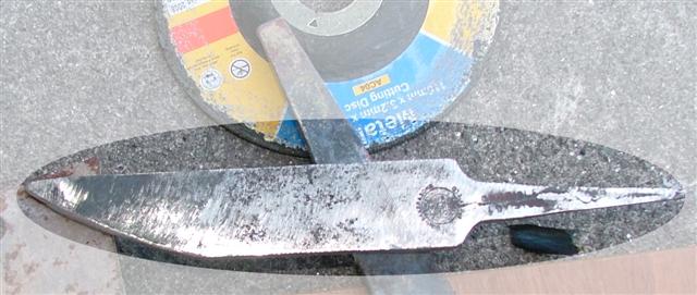

Anyway, the steel I first started on was a lovely little file, the smallest of all our files and apprently 70 years old, it was filthy and black from the fire (to soften the steel) but after I took off the crap with the angle grinder I found a stamp saying it was shefield steel.
For the first time I worked with the angle-grinder on this file and came out with some results:

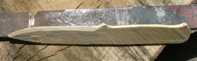

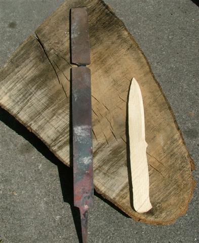

I started off by cutting out the desired template using a thing off cut of light pine, which you can see on the right of the photo. On the left is the largest file in our collection, I think about 38cm long and 3cm wide, with 5mm thickness.
As you can see I had already been to work cutting off the excess near the top.
Here you can see the pine template I created, I think it works in helping you mark the steel and visualise what you're aiming to create.

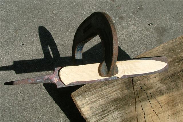

A little help from a G-Clamp and the steel was easily marked out:

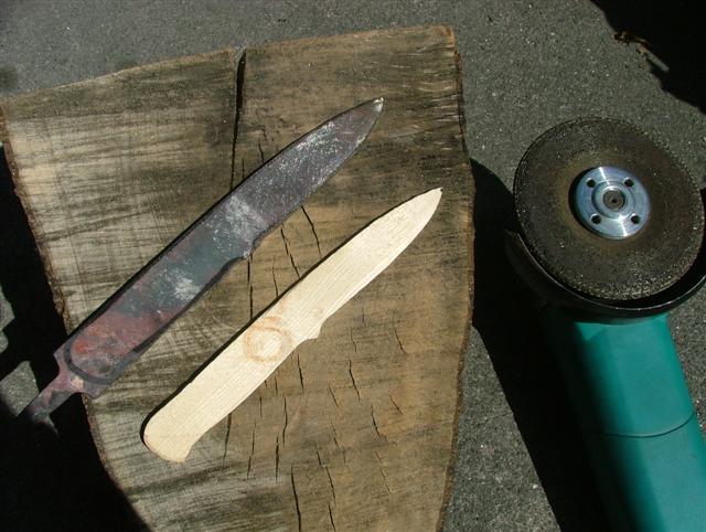

As you can see the knife started to take shape:
Once I got to work on the angle-grinder it didnt take long to do the basic shapping shown above. I probably spent longer on the wooden template! I only had about 20-30mins of angle-grinding then I had to get off to work.
