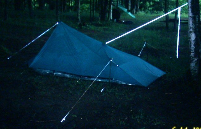

    I use Kelty Triptease lightline. Not only is it light and strong, but you can find your tent or tarp easily in the dark because of the reflective yarn in the cordage.

    I've been trying to find that stuff in the UK for ages! I can't believe the shops here are uninterested in stocking such a big name brand.
  28. #28
    Default
    Quote Originally Posted by blackfriar View Post
    Yeah does your head in doesn't it, by the time we've paid crazy shipping and then import taxes and PO handling fees then it's just not worth it.
    I managed to grab a load of the Exped stuff off a UK seller on ebay but can't find it anywhere over here now. I wonder if Bob at BPL would get a load in, I'm sure it would sell for him.
