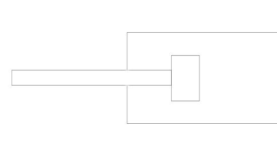

    Have you considered a modified hidden tang with a nut on threaded bar or a long bolt instead ?
    Looks roughly like this (apologies for the crude, thrown-together image):
    The slot for the head of the bolt can be done easily by drilling a couple of holes and squaring them off with a file, and the main slot can be cut in with a cutting disk on an andle grinder. Chamfer off the edges of the slots to take a good weld, weld the whole lot up and grind everything back flush. I usually grind the sides off the head of the bolt before welding to prevent excess heat build-up when cleaning up. Obviously you can make the same arrangement with a nut welded to threaded bar, but either way this is the strongest method I know of for jointed hidden tangs. I prefer silver solder to welding but either will produce an incredibly strong and durable joint - I came up with this method when destruction testing hidden tang knives. When I finally managed to introduce failure (think sledge hammer-level abuse ) it was the joint that caused problems more often than not. This seemed a logical and simple progression to me, and I use it whenever I do a jointed hidden tang that has to be threaded on the pommel end.

    The threaded bar in the pick has been silver brazed to the tang for the reasons you stated (does not enlarge the grain like welding would) i then braze a long nutto the pommel material (the kind you use to join threaded bar together)
    Then i tighten the whole thing up
