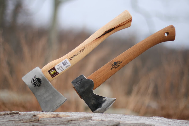

Here you can see the Graintex Single Bit Camp Axe next to the Gransfors Bruks Wildlife Hatchet.
The Graintex hatchet handle is exactly 14 inches, which makes it a bit longer than that of the Wildlife Hatchet, which comes in closer to 13.5 inches. The handle is very comfortable and well finished.
The grain of the handle (left) is good, although not perfect. For a hatchet, the quality is more than sufficient.
