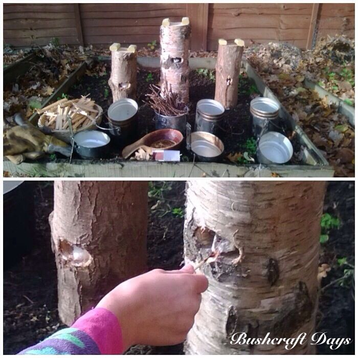

    I cut and trimmed some green hazel to act as pot stands and placed them all side by side in the garden.
    There was very little wind again that day so I made sure I had a chopping board handy to use as a wafter.
    Set up to fire up and with green wood pot stands
    I decided to feed dry split kindling into stove 1, damp twigs into stove 2 (stove 2 was also a damp log itself) and stove 3 would have only the wick and wax.
    My daughter lit each candle with one match each.
    All the additions 1) Dry kindling 2) Damp twig kindling 3) Wax wick
